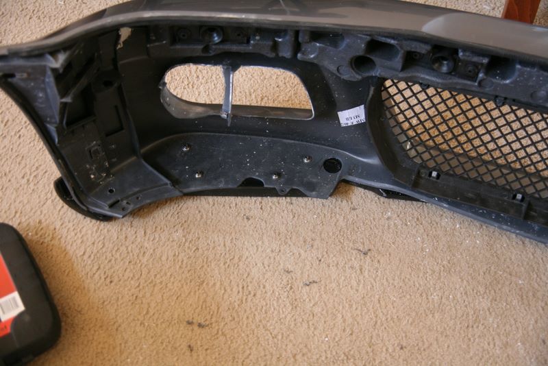

Wife bought me a "Hamann" front spoiler for Xmas and was a little lazy and didn't get around to installing it until today.

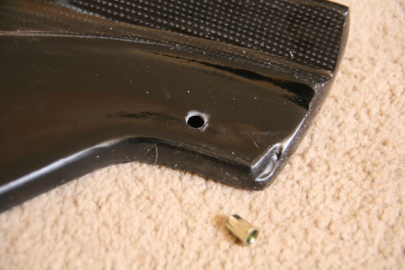

Didn't get any hardware with the spoiler (it was ordered from Modbargains but shipped direct from Taiwan) and so I had to get creative and used rivet nuts (nutserts) to mount the lip. Since the rivet nuts work nicely in blind holes I didn't want extra holes on the bottom surface of the spoiler to collect dirt, etc.
I laid out the bumper on the lip to figure out where to put the mounting holes. I used a 1/8" drill to make some pilot holes through the bumper and lip spoiler.
1. Drill hole for rivet nut - Drill only in the top surface and don't drill completely through.

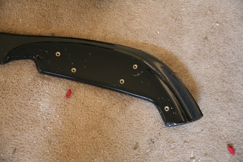

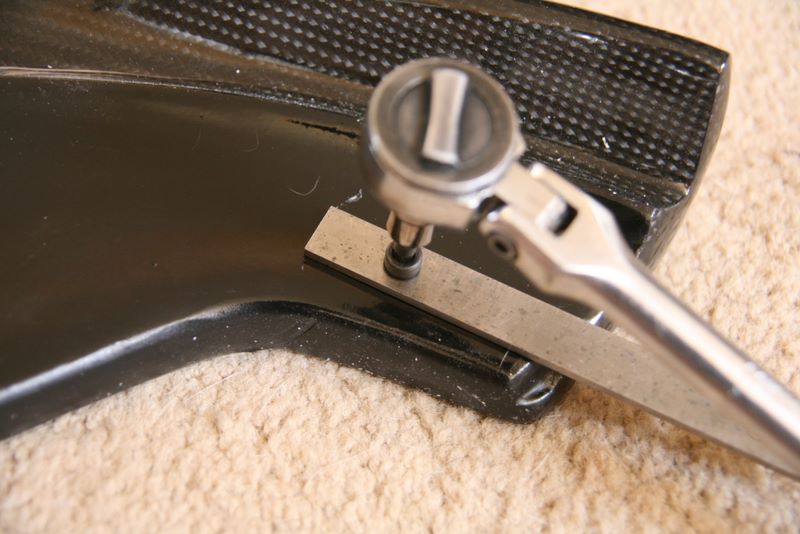

2. Install rivet nut/nutsert
2.a (repeat 1 & 2)
3. Screw onto bumper

P.S. you don't really need a nutsert tool. You can easily rig one up with a nice steel plate with a hole in it (what I used above is a steel parallel off our manufacturing shop).
