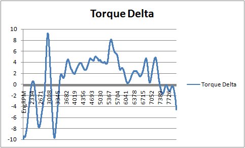

An ECU upgrade affects a broad range of motor performance. Therefore comparing before and after results cannot be summed up by a single number. Max HP and max toque will not be enough; we need to look at the entire graph of performance over the broad RPM range.
The ESS Tuning ECU upgrade gains its performance by opening the throttle valves earlier and changing some of the fuel/air mapping tables, spark timing, and camshaft timing. On a stock BMW M3, the ESS ECU upgrade has shown a net +10hp gain; on mine, we gained 6-8 horsepower in some areas, but lost 1-3 horsepower in others.
Dyno results:
The ESS ECU upgrade produces reasonable torque gains over a broad RPM range. Even though max torque is approximately identical to our baseline, there are significant torque gains from 3300-7400 RPMs. Since horsepower is a function of torque and RPM, we also see similar horsepower gains in this same RPM band. At the very top, we lost about 3.5 horsepower over our baseline configuration, but this only occurred at the very top of the RPM range. In my opinion, a slight loss is more of a psychological defeat, than the actual loss will be in real life. Regardless, even the slightest loss on my car sent the guys at ESS looking for answers. Within 24 hours, they managed to send my exact car ECU configuration files to their home office, download into a US-Spec car and test the results on a Dynojet -- showing a net 10hp gain on a stock vehicle (see graphs below).

To help decipher where the ESS ECU adds and subtracts power, The following graphs demonstrate where the gains and losses occurred. Since measuring below 3000 RPMs is difficult and produces wildly erratic results, the deltas in the lower RPM ranges can safely be ignored.
Torque Delta:

I still don't know why the max hp results were lower than my baseline. These differences are possibly due to the upgrades I've already made to the car, and also possibly due to the other problems we had during testing. The modifications I've already made might be forcing the ESS ECU into situations that did not exist on the stock motor they used for development. Running low on fuel might have caused the ECU to go into 'safe mode.' Then the gas itself might be at fault. I've always used Union '76 91 octane fuel during all of our testing. After the dyno results were done, my wife informed me that the Union '76 station on the corner by my house, is no longer Union '76 and now sells no-name brand gasoline! I doubt this will make a difference, but I might as well list it as a variable in the equation.
