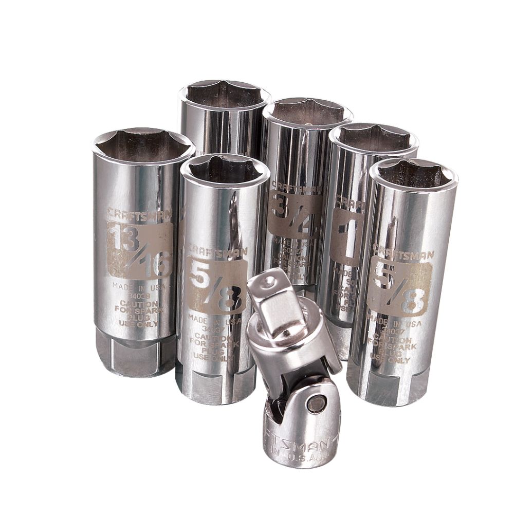

I haven't done headers but you'll probably need some universal joint adapters\extentions. These swivel to get in wierd places. Like the one pictured with these sockets.
Yes those are a big help!!!
