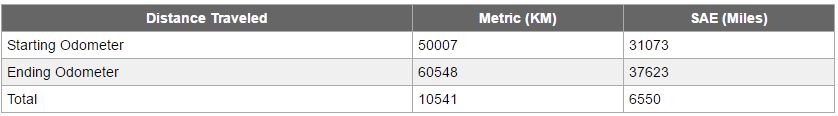

  • 2008 BMW M3
  • 100% stock engine with 30000 miles
  • Stock ECU
  • Stock exhaust

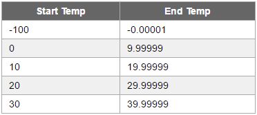

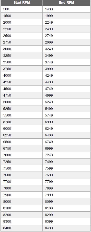

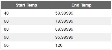

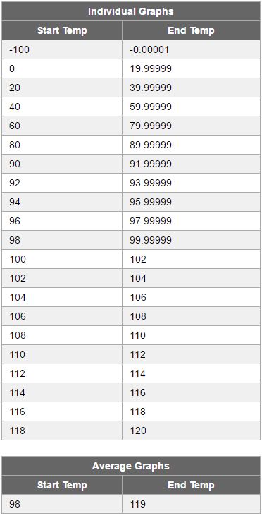

For any given temperature range, a set of RPM ranges is defined for analysis. Any samples found within that temperature range, and RPM range are averaged. For mid RPM, tens of thousands, sometimes over one-hundred thousand samples will be averaged in a given temperature and RPM range. This method is intended to smooth out the results and limit the effect of outlying data.
Temperature Graph Ranges
RPM Ranges
Cold Start Temperature Ranges
Warm Start Temperature Ranges

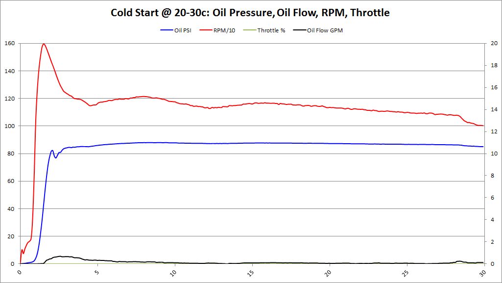

Once you start your car, have you ever wondered how long it takes for oil pressure to build and oil flow to start? This is the section that shows what it looks like.
Charts and graphs will show what it looks like from the time you press the "START" button to 30-seconds later. The chart shows how long from “START” until 70% and 90% oil pressure is attained.
During testing of BMW factory 702/703 bearings, we discovered best results were obtained by pushing the start button, and letting the car idle for 30-seconds. Too many times during 702/703 bearing testing, we were in a hurry where we just started the car and drove off. This tended to skew the data collected.
While testing BE Bearings, an adjustment was made to let the car idle for 30-seconds after start. The net effect is that 702/703 data collection methods are slightly different. However, the 702/703 data will look better than it actually is. If the BE Bearing data shows better than factory, then it's a true results and not influenced by a "start-and-go" driving style we used on the 702/703 bearings.

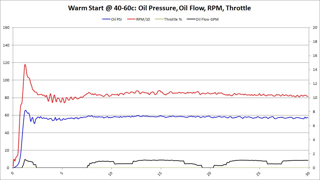

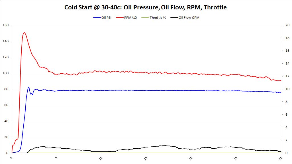

  • Cold Start: Oil Temperature < 40 deg (C)
Each cold start was data logged. Data logger was powered up and obtained GPS signal. Once the GPS signal was locked, the data logging was started. After data logging started, the vehicle was started. This allowed the entire starting sequence, low RPMs with the starter, oil pressure, and oil flow to be tracked during the cold start procedure.

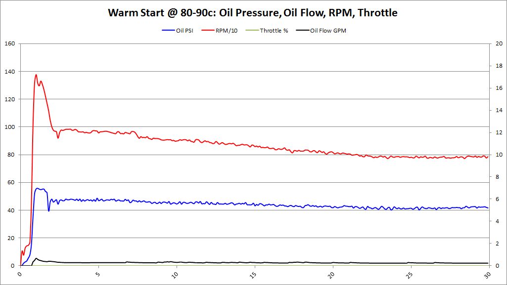

Warm Start Analysis
  • Warm Start: Oil Temperature > 40 deg (C)
Exact same procedure as cold starts, and for the same purpose. Data logger was powered up and obtained GPS signal. Once the GPS signal was locked, the data logging was started. After data logging started, the vehicle was started.

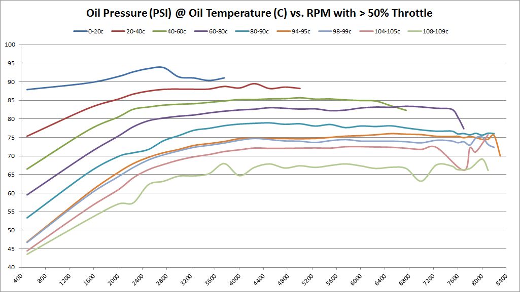

The factory oil pump is a variable displacement vane (variable pressure) oil pump.
Oil pressure in the S65 varies with temperature. This is expected because as the oil is colder, it is more viscous. As the oil heats up, it becomes less viscous and reduces the pressure.
If minimum oil operating oils pressure is 4-BAR (58 PSI), then data logs and graphs will show which RPM level achieves that minimum requirement. Again, that answer will depend on oil temperature – as colder oil is more viscous and produces more pressure.

  1. Average Oil Pressure: All data collected between at the Temperature Ranges listed above. The data within each RPM range is averaged. This is the best demonstration of long-term oil pressure behavior in the S65.
    • Graphs are presented with 5%, 30%, and 50% throttle input.
    • A chart is presented to show minimum RPM where min oil pressure (4-BAR, 58-PSI) is acheived.

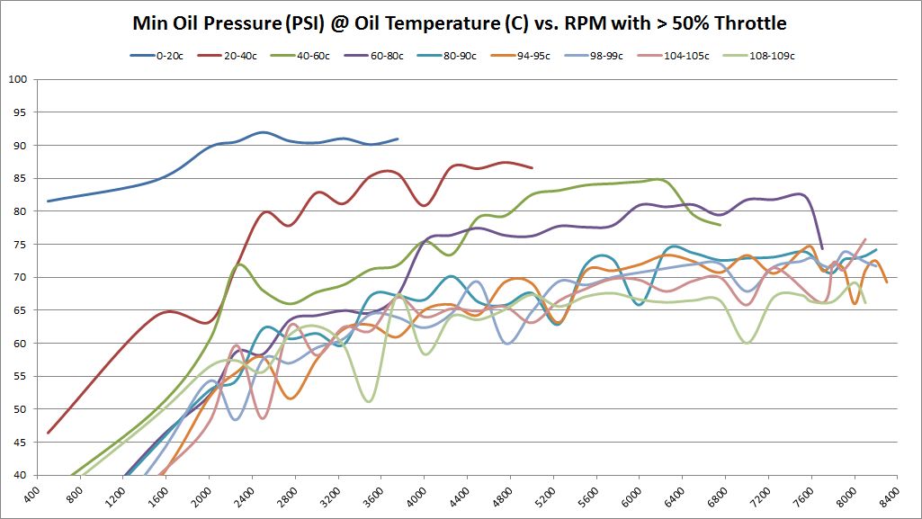

  2. Minimum Oil Pressure: This is interesting to see, but not terribly useful to draw meaningful conclusions. These are single samples, absolute minimums, of oil pressure over temperature and RPM. The one possible use might be to see how BE Bearings affect the absolute minimum oil pressure.

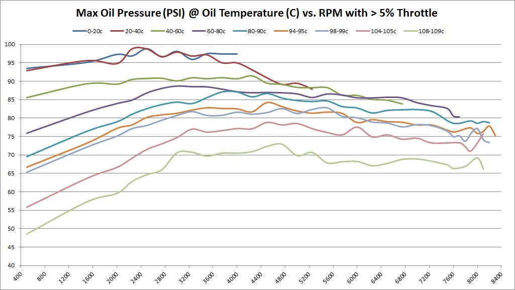

  3. Maximum Oil Pressure: This is the converse of minimum oil pressure. Again, not terribly useful, but interesting to see. The one possible use might be to see if BE Bearings have lower absolute maximum oil pressure measurements over factory bearings.
    • A single graph is presented from 5% throttle input.

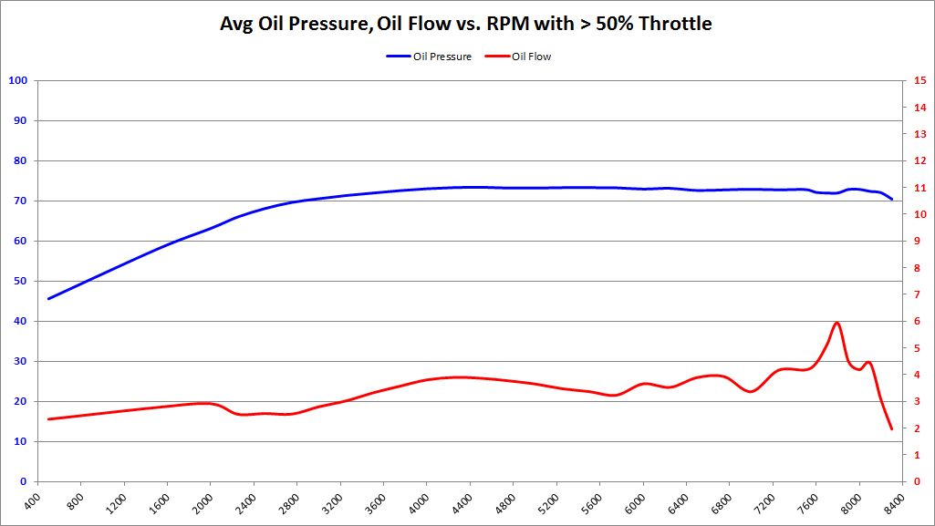

Oil flow is measured with a Flow Technologies turbine flow meter between the engine oil filter outlet and oil cooler. This is the only place outside of the engine that the sensor could be placed. Oil flow to the cooler is thermostatically controlled. When the engine is cold, or just doesn’t feel like it, no oil is sent through the oil cooler – and thus not measured by the oil flow meter. Our programs used to measure and graph oil flow take this into account and ignore times when the thermostat is closed and not sending oil to the oil cooler.
Oil flow in the S65 varies with temperature and RPM. Oil As you would expect, the higher the engine RPM, more oil flow will result. But a little less obvious, oil flow increases as the engine heats up. This is because the oil becomes less viscous with increased heat.

  1. Average Oil Flow: All data collected between at the Temperature Ranges listed above. The data within each RPM range is averaged. This is the best demonstration of long-term oil flow behavior in the S65.

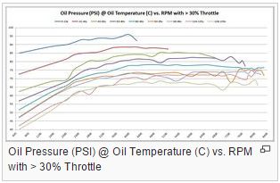

Average Oil Pressure at various temperatures vs. RPM
These graphs show the oil pressure average of all available samples at various temperatures and throttle ranges over RPM. The graphs do change slightly between 5%, 30%, and 50% throttle. The primary graph, 50% throttle is shown here. Click the thumbnails of the other graphs to enlarge each one.

These graphs show the oil flow average of all available samples at various temperatures and throttle ranges over RPM. The graphs do change slightly between 5%, 30%, and 50% throttle. The primary graph, 50% throttle is shown here. Click the thumbnails of the other graphs to enlarge each one.
Average Oil Pressure and Oil Flow
These graphs show the average oil pressure and average oil flow average of all samples between 98-119c, and throttle ranges over RPM. The graphs do change slightly between 5%, 30%, and 50% throttle. The primary graph, 50% throttle is shown here. Click the thumbnails of the other graphs to enlarge each one.

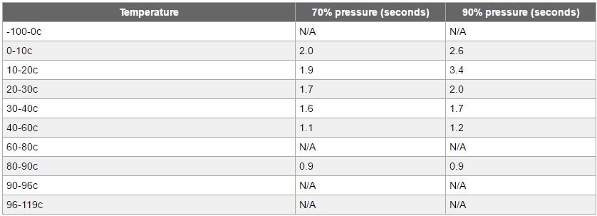

The following chart amd graphs will show what it looks like from the time you press the "START" button to 30-seconds later. The chart shows how long from “START” until 70% and 90% oil pressure is attained. After analyzing some of the data, it appears the throttle input might have been influencing the maximum oil pressure and flow. Had I known this, I would have not introduced any throttle until 30+ seconds after starting the car.

According to this chart, the BE Bearings take less time to reach 70% and 90% oil pressure compared to their BMW OEM counterparts. Not only is it less time to reach full oil pressure, it seems significantly less time to reach full oil pressure. This is a bit of a shock to me and something I never expected to see.
Trend 2016-12
Four of six temperature ranges showed improvement over previous baseline.

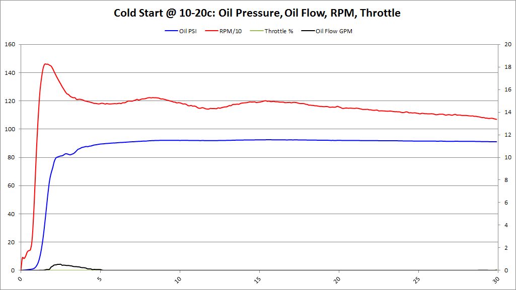

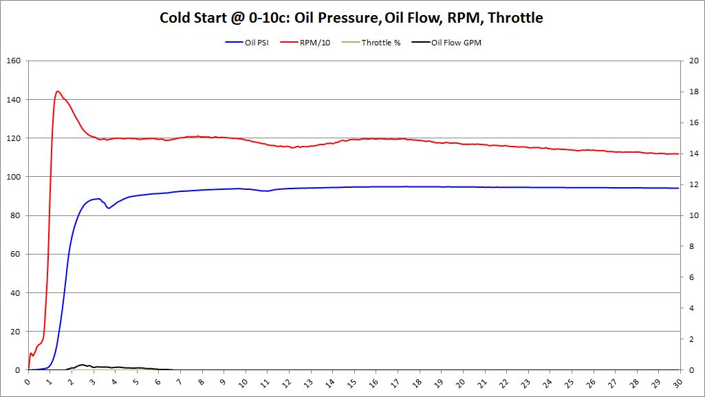

Cold Start Analysis
Summary Oil Pressure, Oil Flow Tests
BE Bearings
BMW Factory 702/703 Bearings
  • Most likely outlying data caused to throttle input
Summary
Trend 2016-12
Cold Start Graphs
Summary
These graphs show both BE Bearing and BMW Factory bearings (as lighter colors). It's very clear from these graphs, that the oil pressure comes up faster with BE Bearings than BMW Factory bearings. Having oil pressure come up faster and lubricating the bearings is a huge benefit to reduce bearing wear and increase bearing longevity. This was an unexpected surprise that we didn't anticipate. The graphs also show no decrease in oil pressure over factory bearings. This should allay fears that increased clearance would decrease oil pressure, especially during this critical "Cold Start" time period.
Oil flow does seem to modestly increase as well. This was an anticipated outcome, but it's good to see it on the graphs.
Warm Start Graphs
Summary
The trend with continues from our Cold Start graphs to our Warm Start graphs. Oil pressure comes up faster with BE Bearings than BMW factory bearings. Oil flow shows modest increases as well, but we'd say this is fairly inconclusive -- especially above 80c. Those graphs contained too much throttle input, and we think that contaminates the results. Now that we know this, we will see if we can filter out the results containing too much throttle, and moving forward will capture results without any throttle until 30-seconds has passed since starting the engine.

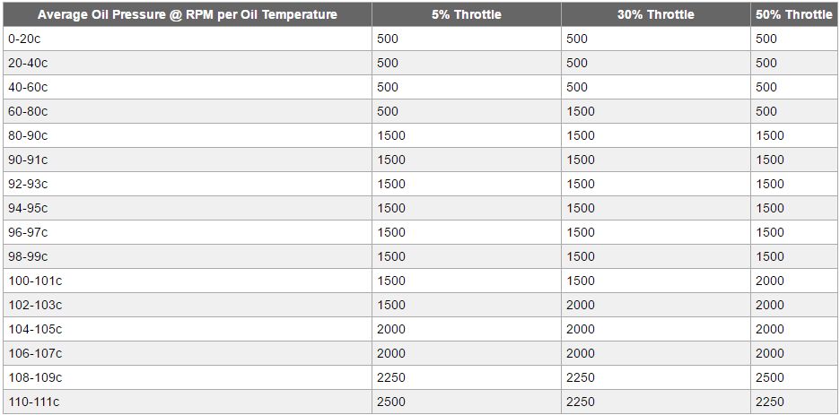

RPM of minimum oil pressure (4-BAR, 58-PSI)
If minimum oil operating oils pressure is 4-BAR (58 PSI), then it’s interesting to see on this graph at what RPM that goal is achieved. Again, that answer depends on oil temperature – as oil is more viscous and produces more pressure the colder it is. As these graphs show, the minimum operating oil pressure at minimum RPM appears to be right around 2500; that’s where we get minimum 4-bar pressure regardless of oil temperature.
The following chart shows average oil pressure vs. RPM. It shows what RPM achieves minimum recommended 4-BAR (58-PSI) oil pressure. This chart highlights areas that have increased performance, decreased performance, or stayed the same. Areas marked in GREEN show an increase in performance. Areas marked in RED show a decrease in performance. Everything else is unchanged.
Summary: There was one area of decreased performance, but multiple areas of increased performance. The increased performance is starting to make more sense after seeing how cold and warm starts come up to pressure quicker with BE Bearings than factory BMW bearings. The same phenomenon may be at play here, or may be something difference.
Trend 2016-12:
  • 5% Throttle: no change
  • 30% Throttle: improved at 102-103c
  • 50% Throttle: improved at 96-97c
Absolute Minimum Oil Pressure at various temperatures vs. RPM
So far, the data being shown are averages across millions of samples. But what about absolute minimum and absolute maximums?
These are the same set of graphs as above, but show the absolute minimums. The absolute minimums are the minimum oil pressures collected across all temperature ranges. They are graphed here to show just how low the pressure can go. Some of this may have been observed during hard cornering (more on that later). So it's hard to draw any hard conclusions based on these graphs. They are offered for informational purposes only to let the reader draw their own conclusions.
Absolute Maximum Oil Pressure at various temperatures vs. RPM
Conversely, the final graph in this set shows the absolute maximums. There's no need to show maximum graphs for different throttle levels because the maximums are absolute and every graph would be the same.

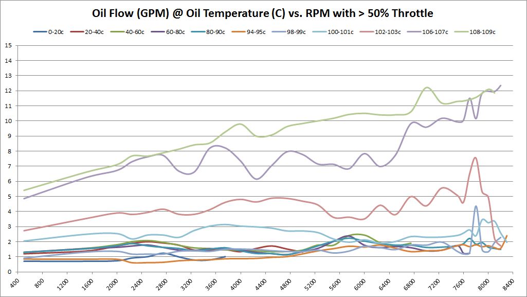

Oil Flow Analysis
How oil flow changes with different oil temperatures and RPM
Summary
Overall, oil flow increased with BE Bearings over factory BMW 702/703 bearings. For upper oil operating temperatures, the oil flow seems to have increased substantially. At lower oil operating temperatures, the results are inconclusive -- just by looking at the graphs.
Our hopes with BE Bearings were to allow a modest drop in oil pressure, so long as it was accompanied by an increase in oil flow. These graphs don't tell us much about pressure yet, but they do show rather significant increases in oil flow.
Trend 2016-12
  • 5% Throttle: As more data samples become available over time, the data starts to converge. Oil flow increased 0.25 - 0.50 GPM almost across the board in all temperature ranges and RPM bands.
  • 30% Throttle: Same observations as 5% throttle.

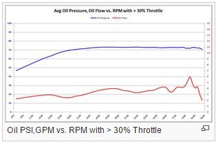

Summary
Primarily, we want to know if BE Bearings cause an average decrease in oil pressure, and if so: how much? We also want to know if the BE Bearings increase average oil flow, and if so: how much?
This is the graph answers both of those questions in a rather obvious way.
  • Oil Pressure: Oil pressure does seem to decrease slightly with BE Bearings. This is most likely due to the extra clearance. But the amount of decrease is between 2-3 PSI, over a 70+ PSI average. Assuming the 73 PSI average, a 3 PSI pressure drop is equal to 4% of the total. Whether it was the 5%, 30%, or 50% throttle input, the results were all the same: a 2-3 PSI drop over a 73 PSI average. This is proof positive that the S65 variable displacement oil pump is doing its job.
  • Oil Flow: The most significant change between factory and BE Bearings is the oil flow. We were hoping for a modest increase in oil flow to offset a modest decrease in oil pressure. But the resulting oil flow is nearly double with BE Bearings over the BMW 702/703 bearing counterparts. Having double oil flow over the bearing surface increases the wedge strength and keeps the bearings cooler. The results with BE Bearings seems to be a huge win, much bigger than any of us expected.
Trend 2016-12
  • 5% Throttle: As more data samples become available over time, the data starts to converge. Oil pressure began to converge to BMW 702 pressure levels. What was a 2-3 PSI drop with BE Bearings, has gone down so about a 2.5 PSI drop. Oil flow showed a reasonable increase in all RPM bands above 5000. The wild variations seen in previous data start to disappear as more data samples are available.
  • 30% Throttle: Oil pressure got smoother, but otherwise didn't change enough to mention. Oil flow showed a reasonable increase in all RPM bands above 4000.
  • 50% Throttle: Oil pressure got smoother, but otherwise didn't change enough to mention. Oil flow showed a reasonable increase in all RPM bands above 3600.
