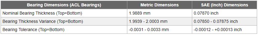

Dimensions
Standard (STD)
+0.250 MM, +0.010 INCH

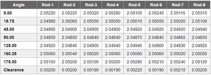

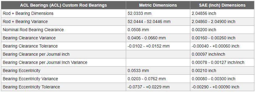

Bearing Clearance Specifications
Clearance Measurements

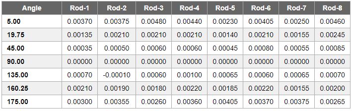

Eccentricity Measurements

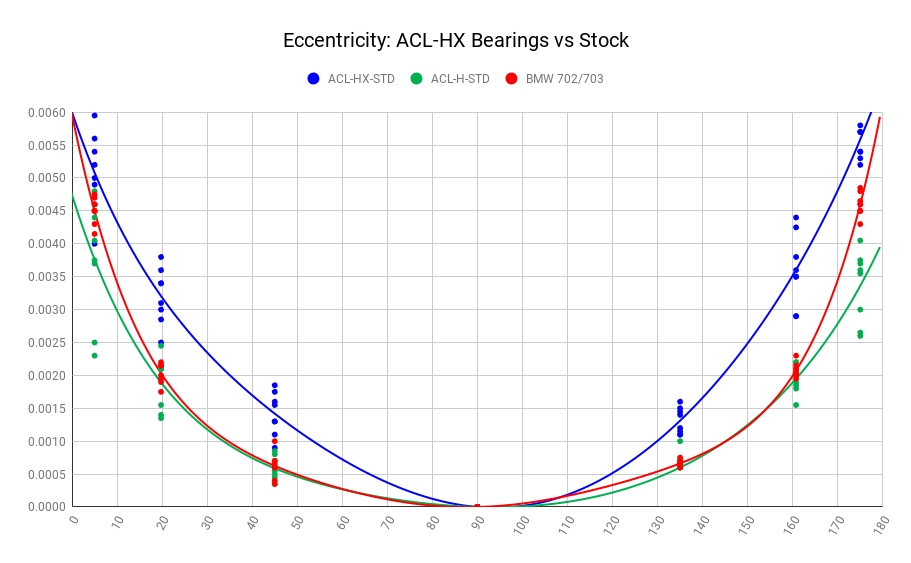

Bearing Eccentricity: ACL Bearings vs. stock 702/703 rod bearings
