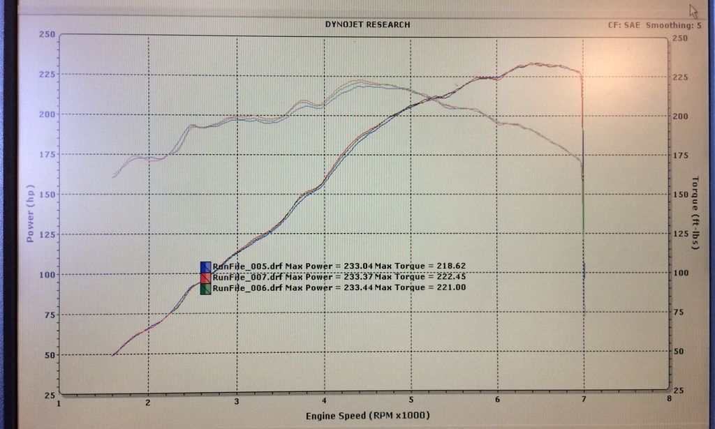

Default Re: Post your e36 M3 Dyno Charts
Chassis Build Date: 10/94
Rebuilt BSP Legal S52
Mods:
- aFe 'Euro' Cold Air Intake
- Euro 3.5" Bosch HFM / Mass Air Sensor
- 3.5" BW Silicone Throttle Body Boot
- STOCK Throttle Body
- 21.5lb Fuel Injectors
- VAC Stage 1 Cylinder Head
- TMS Performance Chip
- TMS Power Pulley Kit
- Fan Delete
- Raceland Euro Headers with Custom Exhaust
- JBR Aluminum Flywheel
Date: June 13, 2015
Dyno Type: DynoJet (Carb Connection - Kirkland, WA)
Dyno Conditions: Temperature 69 F, Humidity 49%
Gear Dynoed: 4th with 3.38 Differential
Peak HP: 233.37 SAE
Peak Torque: 222.45 SAE
