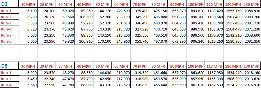

I did a little more digging into the results, and it's very clear that clutch engagement time is different between D2 and D5. I looked at the 60-foot times, and it's clear that the clutch engagement is faster in D5 than D2.
At the same time, I exported as much data from the runs as I thought made sense. I tried making some graphs of the data, but nothing was nearly as clear as simply presenting the data itself.
1/4 Mile results:
Even though these aren't actual drag strip results, I tried to simulate them as best as I could using the VBox tools software. I did my best to look up the NHRA rules and figure out how times, distances, and trap speeds are measured. Then using what I learned, I programmed the VBox software to simulate the same thing. For example, I used a 1-foot roll-out, and the trap speed is the average of the speed at 1321ft, and 1257ft (Q-60 ft, with 1-foot roll-out).
Gear Analysis: Time in Gears
Gear Analysis: Distance in Gears
Speed Analysis: Time to Speed
Speed Analysis: Distance to Speed
