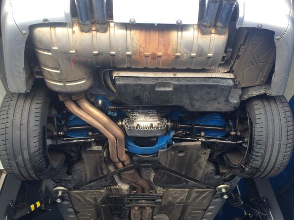

Excuse the glare in this pic. It was the only one I captured showing it in the car. This is before I welded the assembly in.
And lasltly, when I finally had the car fully assembled ready to put the wheels back on the ground. Not a whole lot to see but after all that work it was a big moment.
