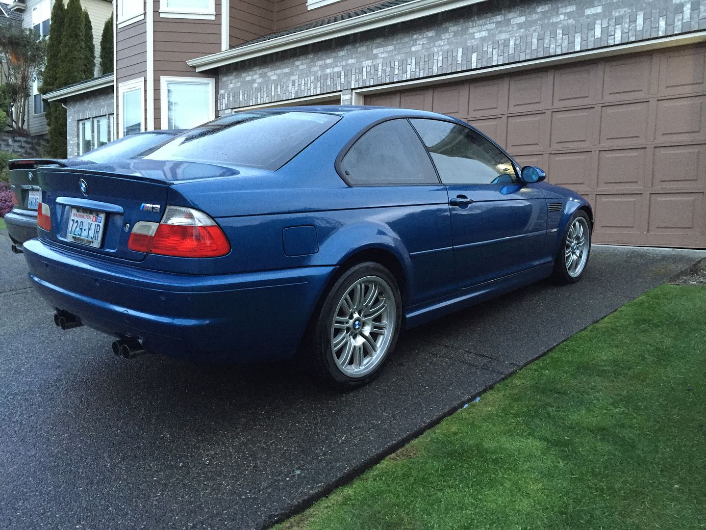

I've checked all the easy stuff. Can't figure out this no-start condition. Can anyone help? The car in question:
